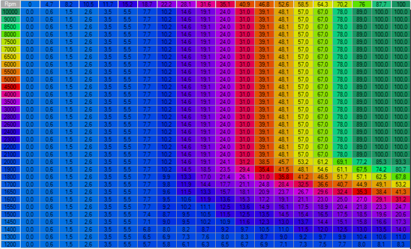

  6. Foorumis siis sai leitud miski trosseli tabel:
    "The idea is to make a very smooth beginning, which is easy to use in technical riding. RPM-relativity is active up to 2000 rpm, so if you whack the throttle below that, you won't get all that you are asking for and the flameout has been prevented. Above 2000 rpm the engine is quite hard to stall anyway with "ADHD" throttle usage.
Aggressive end curve is to give max power quickly. 690's grip twist is quite long. I don't find myself very often using the middle portion of the accelerator. Most of the time I'm using close to 0% in technical riding or commuting. And the rest of the time I use 100% in gravel roads. Or was it the other way round?
Sellega muutus kõik, on võimalik sõita ka 4nda käiguga linnas 60ga, ei jõnksuta ja sõidab ilusti.
Lõpuks ometi on KTM see, mis olema peab ja tarkvaraga sai asja paika. Seega info, kui kellegil kunagi seda peaks vaja minema. Tuneecu lehelt saab ka mappe alla laadida.
